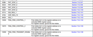

The DP83TG720S-Q1 data sheet does not mention many of the register mentioned in Application note: Configuring for Open Alliance Specification Compliance. such as
and Many more registers are not mentioned in Data Sheet
Can you help provide register related information or software design reference?

  • Hi Animesh,
    There are descriptions for each register write in the app note you have seen. Unfortunately we will not be able to share further details as these are confidential internal registers. Please write the script in the order shown upon power up or reset of the PHY.
