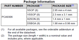

The package size of VSSOP in the Package Information listed in
attached datasheet P1 (fig1 below) is different from the dimensions listed in
datasheet P29 (fig2 below).
In fig2, it can be read as 2.0mm x 3.1mm.
Which information is correct?
           Fig1
        Fig2

    This looks like a datasheet error for the packaging information listed in fig 1. The table seems to be correct for the SSOP and X2SON package types, but VSSOP and DSBGA seem to be off.
    Please look at the mechanical drawings near the back of the datasheet for the most accurate dimensions for the VSSOP package type (or any package type).
    I have taken an action to update the datasheet in the future to list the correct dimensions in the table.
    Tyler
