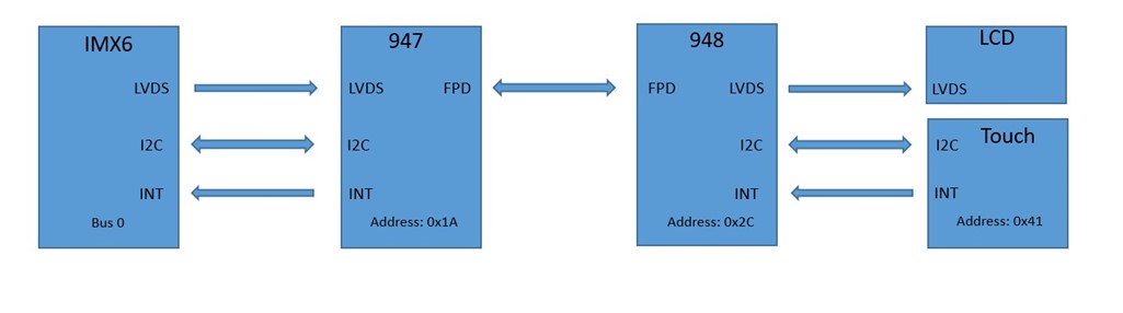

I am attempting to get touch functionality across the BCC. To preface, here's a diagram of the application:
When the TOUCH I2C is connected directly to the IMX6, the touch address 0x41 shows up on the bus and works normally.

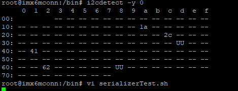

When the IMX6 device is connected to the Serializer 947 as shown in the diagram above, I see the serializer as expected:
And adding in the passthrough enable, slave id, and slave alias, I see the deserializer 948.

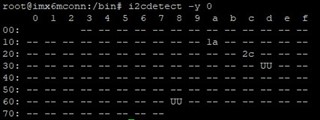

At this point when I enable the passthrough, I expect to see both the Deserializer and touch. However as you can see, I am only seeing the Deserializer. I am unsure what I am missing here and would appreciate any advice with how to see the remote slave touch at 0x41 across the FPD LINK BCC.

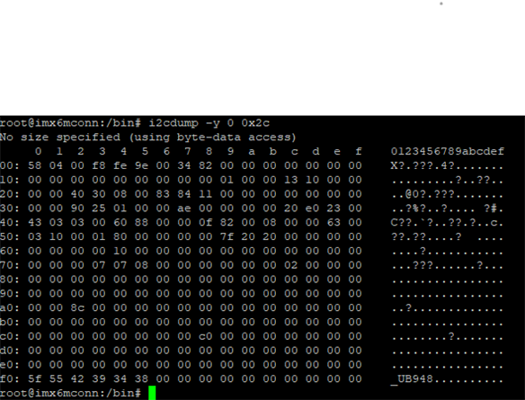

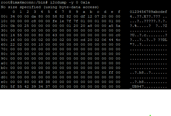

    Here are the register dumps for the Serializer and Deserializer, respectively, after writing to the registers.

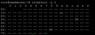

    Even after all these changes, I am not seeing the touch device on the bus nor able to read/write to it.  Are there any other potential settings that may need to be enabled? I have looked at all the registers in the datasheet on both the serializer and deserializer side but have not seen any applicable solutions.

  • I removed those 2 lines and reset. When I probed those lines, IMX6 >> SER>>DESER>>PROBE>>TOUCH, I am not seeing any throughput on the I2C.This lines up with not being able to see the touch device on the bus. Independently, I have confirmed the touch works from IMX6>>TOUCH. Also working in the reverse to ensure the deserializer is not at fault, I tested IMX6>>DESER>>SER and can access the SER registers through the FPD link.

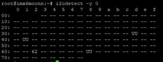

    These are being tested using custom PCBs. I am seeing the touch when going from IMX6>>DESER>>SER>>TOUCH. Attached image shows the bus after using this write to the registers,
    i2cset -y -f 0 0x2c 0x03 0xf8
    i2cset -y -f 0 0x2c 0x07 0x82
    i2cset -y -f 0 0x2c 0x08 0x82
    i2cset -y -f 0 0x1a 0x03 0xda
    i2cset -y -f 0 0x1a 0x07 0x82
    i2cset -y -f 0 0x1a 0x08 0x82
    i2cset -y -f 0 0x1a 0x17 0x9e
    i2cset -y -f 0 0x2c 0x05 0x9e
    I know I did leave some unnecessary register writes from previous attempts in this last trial but I am unsure as to why it works in one direction vs the other.

    We ended up purchasing the eval boards for both serializer and deserializer and still end up with the same issues. This time though, I am not seeing the touch device on the bus in either IMX6>> SER >> DESER > > TOUCH config and IMX6 >> DESER >> SER >> TOUCH config.
