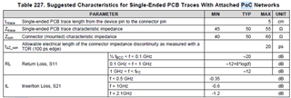

3. table 227. Suggested characteristics for Single-Ended PCB Traces with attached PoC network as below. since customer is designing for system level PCB Traces. they would like to know do we have any suggested for system level PCB Traces instead of Single-Ended?

    3. Could you please clarify this question? Here these recommendations refer to single ended (rather than differential) routing which can be used for coax traces designed to have 50 ohm characteristic impedance.
