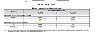

Is it okay that we use 2.2kohm pull up instead of 2.49kohm?
Since there is no 2.49kohm in customer's library so, if it strictly need 2.49kohm, they have to put 2pcs of 5kohm in parallel or so.

The voltage at the pin must be below 0.6 V or above 1.3 V. You can use a resistor value that is smaller than the suggested value; the only effect is that the current flowing through the divider formed by the two resistors is slightly higher.
