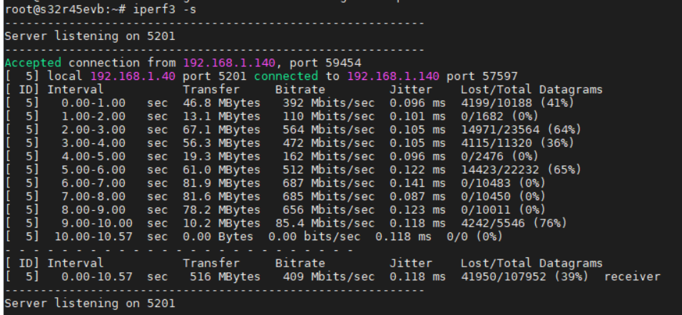

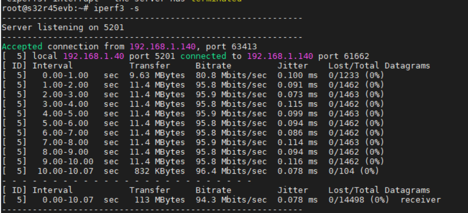

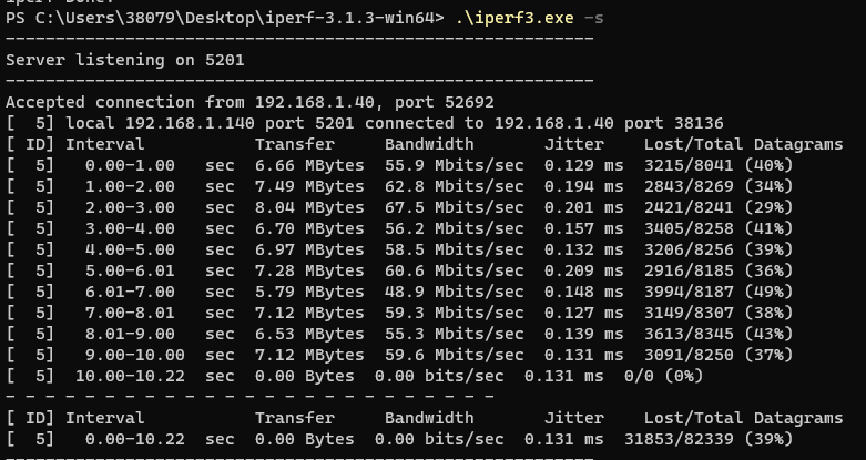

The test is as follows:
1) Gigabit Upstream Test: Forces the PC into adaptive mode but is recognized as 1G and immediately shows link down on the PC side.
2) Gigabit Downstream Test: Force PC into adaptive mode which will be identified as 1G, and some packets lost, there is link down/up after long operation.
3) 100 Gigabit upstream Test: Force PC to 100m Mode. Packet loss occurs, and link down/up appears after long time of operation.
4) 100 Gigabit Downstream test: Force PC to 100M mode, and it runs properly.
5) The reset port voltage is always detected as high, and no reset was observed during data transmission.
6) Chip port supply voltage monitor with no drops during data transmission.
Could you help check this case? Thanks.

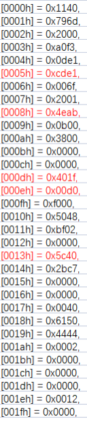

    Could you read register 0x0000 to 0x001F when then the link is down and up?
    Registers 0x0000 through 0x001F read when link down as shown in the following figure:

  • Hi Zhou,
    Based on your register dump, I am seeing that you are having a link up through register 0x0001. Could you also send me register dump when the PHY is in link down stage?
