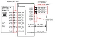

The customer's main system will have a DP signal (Dual lane only) which needs to be converted into an HDMI signal and output to the HDMI connector. They plan to use TI SN75DP139RSBR, but because their DP signal only has dual lane, the architecture diagram is as follows. I would like to confirm with you whether this method of use is correct or needs adjustment?
