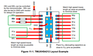

What is the length of the A0p/A0n and A1p/A1n in the TMUXHS4212?
