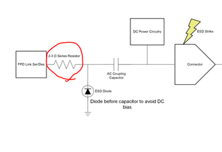

Hello Team,
As E2E post title, does user need to apply serial resistor for POC use case when use protection device TPD1E01B04??
I am worry if this affect to channel loss. is this align with FPD team. because FPD team didn't recommend to apply serial resistor for IVI SerDes case.
