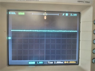

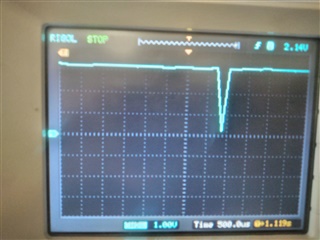

I bought 2 SN65HVD230 modules 1 week ago, but when I connect them to the MCU, a bit timing error occurs in the MCU. Do you think it might be because my SN65HVD230 module is a clone IC?
The code written on SN65HVD230: VP230 CTCVG4

								Sergen,
Thanks for bringing this to E2E, but we'll need more information. When the bit timing error occurs, what are you trying to do? And is it possible to share a schematic and/or waveforms from an oscilloscope when you're using these modules?
Eric Hackett
Sergen,
What is the state of pin 8? It needs to be pulled down to GND for the device to be in the correct mode for communication.
