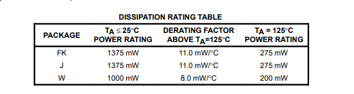

    3. Potentially - there is a decently high chance that one short could put device into thermal shutdown- please see power dissipation table:
    Exceeding these power ratings may cause the device to go into thermal shutdown - as the power dissipation ratings is the power required to bring junction temperature to max rated temperature (after which thermal shutdown could potentially start)
    Please note the derating is for TA > 25C not 125C (power rating at 25C is 100 * derating factor higher than power at 125C - so there is a typo).
    So for example if you are using the "W" package at 100C and during a short you exceed 400mW (P_MAX(100C) = (1W - (100C - 25C)) * 8mW/C) then the part may go into thermal shutdown (thermal shutdown may happen at junction temperatures higher than 150C)
    The type of short will also matter. If it is just a Y to Z short - with no external voltages applied the power it would consume would be approximately 17.6 * 0.25^2 or 1.1W (1100mW) if current reached max value (most likely it will be less). The 17.6 comes from a very quick approximation of (VCC - 2*Diode_drop)/(2*RON) = IOS where the 17.6 is 2*RON with the assumption that the diode_drop is 0.3V and IOS reaches its max value of 250mA.  So by this quick approximation short circuits will have a decently high chance of pushing device into thermal shutdown. This is going to be an issue on pretty much any quad channel RS-485 or RS-422 device as they can burn a lot of power during shorts. You can increase the power rating by adding heat sinks to the device - but we don't really specify much information that would help in sizing a heat sink.
    It would be best if using this part to assume 1 short can throw the device into thermal shutdown (depending on actual current, package, and ambient temperature) so designer should include that consideration into design as it is a potential application scenario that would drive the device into thermal shutdown so there should be  some contingency plan for when/if that happens.
