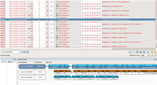

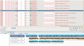

I met this  same problem :https://e2e.ti.com/support/interface-group/interface/f/interface-forum/1219898/tusb7340-tusb73x0-superspeed-usb-3-0-xhci-bulk-isochronous-error
Using a USB 3.0 protocol analyzer in between, for bulk transaction, when the issue happens, we captured lots of error.  HOSTerr. and retry.
From https://www.ti.com/lit/ds/symlink/tusb7340.pdf?ts=1684093075880&ref_url=https%253A%252F%252Fwww.google.com%252F
I saw TUSB73x0 also provide 7.5.1.65 De-Emphasis and Swing Control Register. please check 7.5.1.65.
Do you have any tool to tune this De-Emphasis?
why HostErr happens, does TUSB73x0 provide any debugging register? thanks.
And  said it may be a linux driver problem, is there any deeper issues to dig into? please help me.thank you very much.
