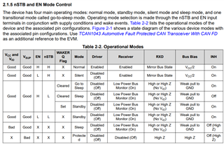

I don't know what good and bad mean of VCC and VIO, Vsup as below pic. Could you please explain more detailed?

Jimmy,
You can look at this as an under voltage equivalent: good means the rail is not in under voltage, being supplied in the correct range, bad means the rails is not being supplied within the recommended operating range and is in an under voltage condition.
Please let us know if you have any other questions.
