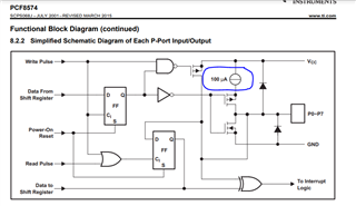

I'm facing a strange behavior with the device PCF8574RGTR. I'm using the PCF to drive an ULN2003A that drives a LED. However, when I turn on the PCF's output the LED does not turn on.
PCF8574RGTR's datasheet shows that the maximum I/O output current is 300uA.
When I turn the PCF's output, I measure 0.8V at it. Considering that the ULN has an input impedance of ~13kOhm, 0.8V at its input pin means that the PCF is sourcing only ~60uA. Is that correct? If so, why isn't it sourcing almost 300uA? If I place a external 100kOhm pull up at PCF's output it works, and the output voltage goes to ~1.6V.
When I use the device PCF8574TS/3,188 (from NXP) it works without the external pull up, and both devices have the same specification for output I/O current. Can someone explain what I'm missing?
  • Hi Lucas,
    PCF8574 has 100uA pull-up current source when driving logic high
    How are you writing to the PCF8574 to configure the output? Do we have scope shots to show this?
    I would expect to see at least 100uA of current being sourced.
    What is the resistor on the diode, and what is the forward voltage of the diode?

  • Measuring a voltage above zero shows that the output tries to drive high, so the I²C communication should be OK.
    The ULN has a typical off-state input current of 65 µA, and requires more to switch on. Apparently, the NXP device outputs a little bit more than the TI device, but the guaranteed minimum is only 30 µA.
    A pull-up resistor would be able to supply more current. Alternatively, use a device like the PCA9534/TCA9534 that has proper push/pull outputs. Alternatively, use a driver with high-impedance inputs like the TPL7407LA. Alternatively, use an integrated I²C LED driver like the TLC59108(F).
