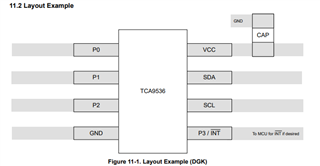

In the typical application of the datasheet, there is no capacitor between VCC to GND.
However, on the EVM, there is a capacitor, 100nF.
Would you typically recommend a capacitor here? which design should customer follow?

Yes this is a mistake on our end. I have taken a note to fix it.
Our layout example shows a decupling supply cap and its placement to VCC, but we negate the value of the cap here.
Customer should follow adding a decoupling cap to the supply line here. 100nF or 0.1uF cap close to the VCC pin is highly recommended.
