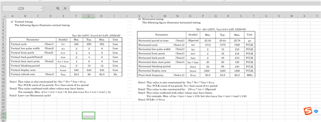

  • hi jack,

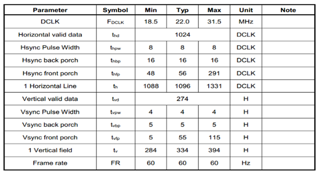

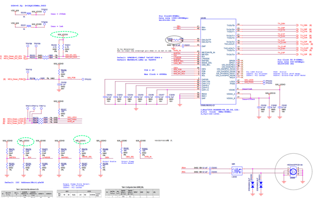

    add the more information, 941 use super frame pair with 926 and 928, 926 is for cluster , 928 is for HUD.
    the follow is the 928 schematic and video timing .
    the follow is the video timing of 926

  • Hi Chen,
    Thank you for the information on this system and for the background info.
    Because the link is there for both the 926 and the 928, there is a timing issue causing the 928 to not output video. I will be sending a script to run the patgen on the 941as to verify that the video path has no issues. Once we get the patgen working, we can fix the superframe input issue.
    There is an app note for 941AS splitter mode operations. I'll attach it if you haven't come across it yet.
    Link
    Jack

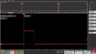

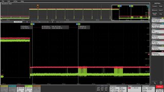

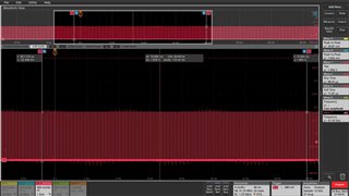

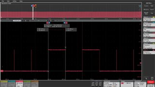

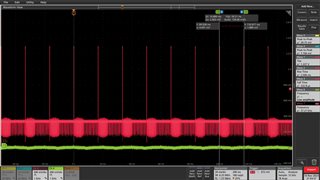

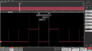

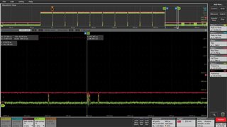

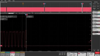

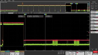

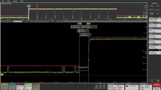

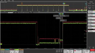

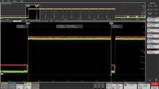

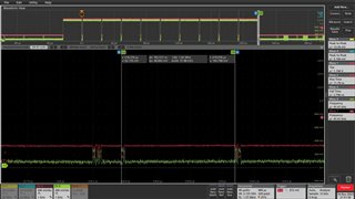

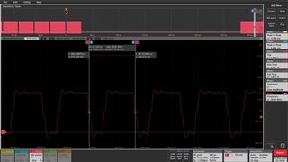

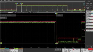

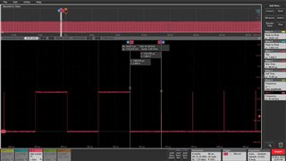

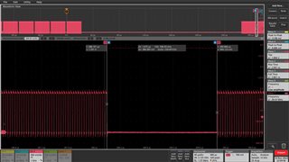

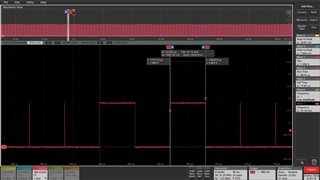

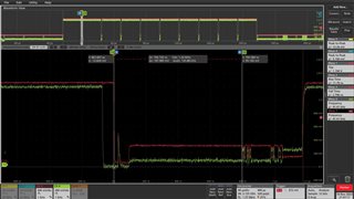

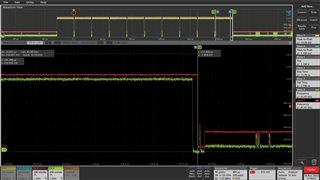

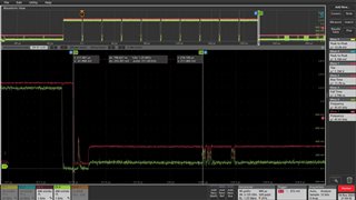

    4 、we test the 941 pin -- GPIO 14 ,38 、39 and line0,please help us to analyse the picture from those pins,
    GPIO 14 picture
    pin 38 and 39 picture
    Line0 picture

  • Hi Colt and Chen,
    Thank you for confirming that the 941 patgen with internal timing and internal clock works successfully. From the images you sent over, I can see that the SoC is entering LP-11 every frame so that is not an issue.
    it's more like timing issue, right?
    Yes, this is most likely a timing issue. For alternate pixel superframe, the incoming video frame must consist of two identical size images. Because the downstream displays are not of equal size, was the SoC adding padding to the incoming images?
    Since we can get 941 patgen working with internal timing and internal clock, let's check that external clock and external timing will work for the patgen.
    Use the below script to enable 941 patgen with internal timing and external clock. If the script works then the DSI clock is working as expected.

      now ,please help us to confirm 941 whether can support the 926 cluster and 928 hud can output the required pictures in splitter mode, the cluster and hud  timimg as following:
  • Hi Chen,
    I have two concerns with the 941's ability to support this system. The first concern I have with the video timings is that the 928 hud display is set for negative sync polarity ("low pulse width") while the 926 cluster display does not use negative sync polarity. Can you confirm if this is correct? Both displays will need to have the same sync polarity for splitter mode operation.
    The second concern is that the 926 cluster display will not support the additional vertical blanking introduced by the superframe. For the incoming superframe, the 926 vertical timing will have to be padded beyond the 394 max lines indicated in the timing field. This will violate the max PCLK setting.
    Due to the reasons mentioned above, the 941 cannot support these video timings in splitter mode. My recommendation is to use Independent 2:2 Mode for this system as it does not require identical video timings for the deserializers.
    Jack
