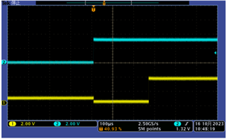

・The following is a comparison of registers for OK/NG. (Left: OK, right: NG)

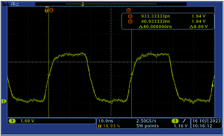

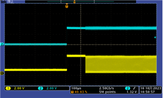

・The [RX_D3/GPIO3] waveform of OK/NG is shown below. (Left: OK and 0x0462 data is 0x0001, right: NG and 0x0642 data is 0x0301)
    *Blue: PHY reset, Yellow: RX_D3/GPIO3
→Enlargement of NG waveform (25MHz output)

    It appears off of the strapping the LED0 is being set into mode 2 which is unideal. This will cause PHY to go into test mode as noted in section 8.5 of datasheet. I would advise probing the line at powerup to understand what is happening at high temperature vs normal temperature and see if the strap is being read correctly by the PHY or if the voltage is being altered in some sort of way.

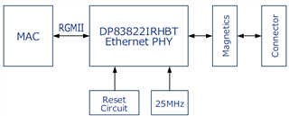

    Could you also please show the differences in the layout of the DAP, and provide schematic of PHY for quick check?

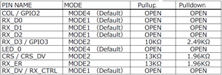

    In the customer's settings, LED_0 should be set to MODE4 (Default), but is it being shifted to MODE2 for some reason?
    ・BOOTSTRAP settings are as follows.
        Address: 0x0467 read bit1:0→0b11 (11=MODE4 in datasheet Table78)

    We are requesting the circuit diagram etc. from the customer, so please wait for a while.
    Is it possible to share confidential information such as circuit diagrams via email or private massage?

    Yes, this is to confirm that the bootstrap waveform is correct at this high temperature. Please send via DM.
