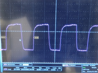

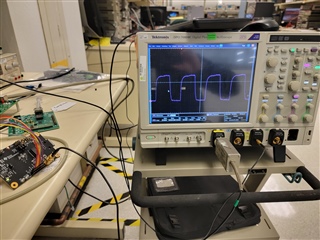

  • Hi DD,
    I did your 1. test can confirmed the shared clock coming from the RMII_Master board is indeed 50 MHz. Please see the pictures below. However I'm not sure what you mean by the PHY switches to 100 Mb. How do you know that this is happening?
     50 MHz CLKOUT signal from RMII Master
    Figure 1 CLKOUT Signal from RMII_Master
    Figure 2 - Picture of setup: SMA CLKOUT cable directly going to Channel 3 of Oscilloscope
    Alvaro
