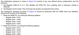

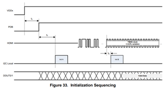

I have a HDMI source -> 949 -> 948 -> 1080p display.
I am trying to keep the HDMI source plugged into the 949 at all times, including through power cycle. However, this results in the display using the wrong EDID and displaying the wrong image. The image can only be resolved correctly by unplugging and replugging the HDMI.
I am using the 949 eval board. I have tried moving switch 5 of MODE_1 high to strap EXT_CTL high on power up. However, this is not working, and the HDMI still connects and displays the wrong image. Furthermore, reading register 0x54 results in value 0x00, rather than the expected 0x80.
Is there a step I am missing to prevent HDMI from connecting before the EDID is loaded?
