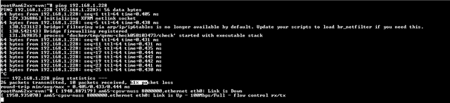

Customer have extracted PHY logs for configuration Please let us know if the registers are properly set PFA.

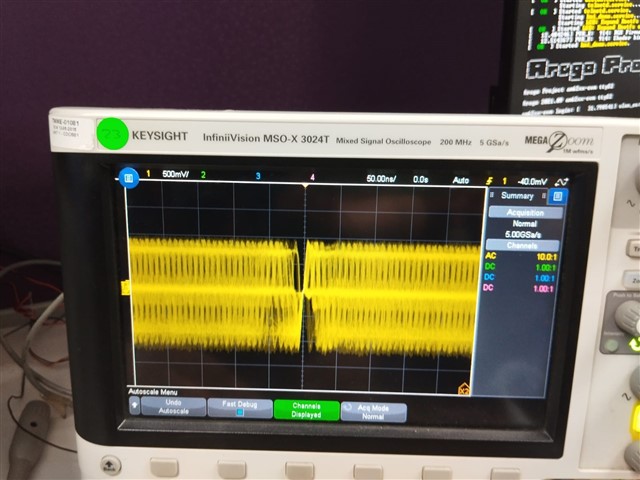

They have packet loss,  operating in 100 Base TX/RX,  PFA wave forms.
 Any tweaking the internal registers for series termination will help ?  Can you share your inputs & suggestions.
Tx.
Rx
Ping Data

  • Hi Matthew,
    Thank you for providing the waveforms and register dump. These are very helpful for debugging. Are these waveforms from the MDI side?
    Could you provide a Block diagram of your system and confirm was MAC interface the PHY is using?
    Alvaro

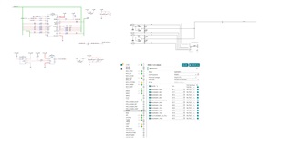

  • Hi Alvaro,
    please find details we are using AM6254 Processor in RGMII Mode as 100 Mbps
    Thanks & Regards
    S.Kashyap
  • Hi Alvaro,
    please find details we are using AM6254 Processor in RGMII Mode as 100 Mbps, wave form across RJ45 connector TX / RX
    Thanks & Regards
    S.Kashyap
  • Hi Kashyap,
    Moving forward I want to align on some terminology, the pins connected the PHY to the AM6254 Processor are the RX/TX lines. The pins connected to the RJ-45 are the RD/TD. Internally we've seen miscommunication among peers due to this difference in terminology.
    Thank you for the schematic snapshots, from it I can just see that the VDDIO level is 3.3 V correct? Looking at your MDI circuit, the connection between the +/- lines look good, except it is being pulled up to 1.8 V instead of 3.3 V. Was this intentional?
