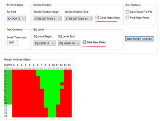

Hello Team,
Today, I realized MAP has been updated with delay option. So I compared it with previous version.
1) MAP result from previous version with 953, 954 EVM.
2) MAP result from updated version without delay option.
3) 2) MAP result from updated version with delay option.

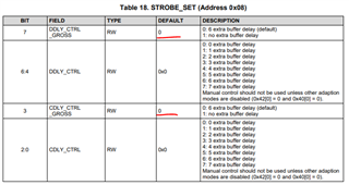

I believe enabling delay option in MAP tool should be for default (6 delay as default)
Am I correct??

I confirmed only disable delay option in MAP tool configure 0 delay from default 6 delay in indirect 0x08 register.
Could you pls check it and help me clarify this??
