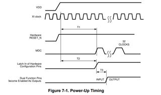

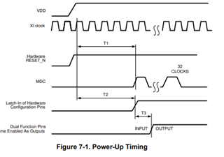

Currently, the PHY uses 3 supply modes (1.0V/2.5V/3.3V). The power-on reset timing diagram is as follows:

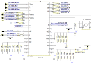

The customer application schematic diagram is as follows:

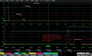

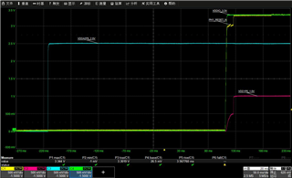

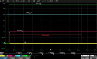

    1.The timing of MCD/MDIO relative to VDDA and VDDIO is as following:
    -The MDIO operation will not access phy until uboot is up. There will be almost 8 seconds in between, as shown below:
    -During the power-on process, MDC is pulled up to about 0.9V for a period. This is output by the PHY chip itself, not by the MCU:

  • Hi Adrian,
    MDC lines should be input only pin for DP83867PHY. I don't think it is possible for MDC to output the voltage. If possible, could you remove the 33 ohms on MDC line and probe the MDC line to see if you still see the pull up on the MDC lines?
    Could you also double check if you have a external pull up resistor on MDIO lines?

  • Hi Hillman,
    Samsung tried removing the series resistor on the MDC, but the phenomenon is still the same.

  • HI Adrian
    The Power up sequence in the PHY do have a significant effect on the DP83867PHY. Is adding a reset after power up would be the solution in your system?
    VDD1P0 power rail does not seems to be a clean signal. Is it possible to smooth the slew rate of the traces of VDD1P0 to see if that could prevent the pull up internally on the MDC lines?

  • Hi Adrian,
    Thank you for confirming. Holding reset for 200ms after VDD1P0 power up should be fine in customer application to prevent MDC trigger beforehand.

  • Hi Adrain,
    Holding reset for for 200us after VDD1P0 power up should be fine in customer's application.
    One of the hypothesis that might cause MDC lines to pull up is the bad waveform on VDD1P0.
