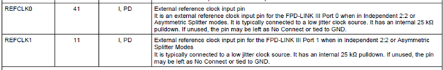

  • Hi Link,
    Correction, the REFCLKx pins which would use an additional oscillator is designed for FPD-III independent asymmetric modes, same as the table you have referenced above:
    The DSI CLK pins you are referencing are also considered an "external source" for driving the PCLK.

  • Hi Link,
    No problem, I may try to clarify this further;
    Do you mean that if there is no DSI_CLK input, an external oscillator is required for the device to work properly?
    No, DSI_CLK will always be there whether the external oscillator is connected or not. The external oscillator is only used when it is in independent mode or splitter mode.
    May I use the internal oscillator to make the device work without the DSI_CLK input?
    Yes, you may use internal oscillator with/without the external DSI_CLK.
    How to determine the conditions for using internal and external oscillators?
    It depends on the application that they intend to use. First, are they using independent or splitter mode? If it is neither, then they do not need the external clock for the REFCLK0 and REFCLK1. They can simply use the external DSI_CLK.
    Miguel

  • Hello, Miguel,
    As specified in 8.4.4.1 and 8.4.5, the work mode that needs the external REFCLK is only as showed in "Figure 8-18. Independent 2:2 Mode With External Reference Clocks" , even in that use case, it also could be replaced with "Independent 2:2 Mode With DSI Reference Clock" as showed in Figure 8-17. So, I have not found any use case which must apply external REFCLK. Is that the fact?
    Thanks.
  • Hi Link,
    2 FPD LINK outputs, which are connected to 2 displays. They have the same resolution, frame rate and color depth, but the displays' content are different.
    Correct, as long as the two DSI inputs have their own DSI0_CLK and DSI0_CLK coming into the 941, there is no need for the external REFCLK.

  • Hello, Miguel,
    In my application: 2 FPD LINK outputs, which are connected to 2 displays. They have the same resolution, frame rate and color depth, but the displays' content are different.
    Even though just one DSI input was used, can I use the solution like "Figure 8-15. Splitting at Serializer Option"? As showed in the figure, it also does not need external REFCLK.
    Thanks.
  • Hi Link,
    Do you mean to say, there is one DSI input to the 941?
    Correct, if the incoming data on the DSI input also includes "DSI_CLK", then it does not require the external REFCLK option, considering that both displays have the same video timings from the input source. Please pay close attention to the configuration described in the paragraph above the figure that describes programming the images and the default values.
