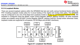

We need a thernet phy that supports the far end loopback mode function, so we are reviewing the DP83826I.
It is mentioned in the DATA SHEET as follows.
Far end loopback mode is supported, right?
Can you also tell me about the REGISTER and setting vaule related to testing far end loopback mode?
