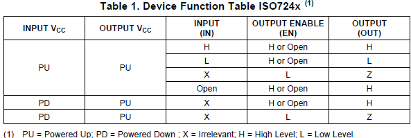

  • ISO7240C is a default output 'HIGH' device. This means that when the input power, VCC1, is 'OFF' or input signal is lost / open, the output will default to a high state.
    After VCC2 is powered up, the outputs will initially take on a high state. If VCC1 (input supply) is powered up, then it'll take several microseconds for the output to align with input signal or enable status (see specifications for tfs and twake in the datasheet).

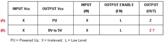

    Additional Explanation
    Let me summarize my question.
    I have two questions on ISO7240C. (not ISO7240CF)
    First, I'd like to confirm output is always "Z"or not whenever enable is low.  On the above function table, I can see output is always "Z" if enable is low regardless of powered up or powered down of Input Vcc(Vcc1).  It seems that enable function is relevant with output Vcc(Vcc2), and not relevant with input Vcc(Vcc1).  Thus I predict output is always "Z" whenever output Vcc(Vcc2) is powered up and enable is low, and it does not relevant with input Vcc(Vcc1).  Is this correct?  (Please refer to the below table (A))
    Second, I'd like to confirm output keeps "Z" or not while Vcc(Vcc2) voltage rising from 0V to 5V.  On my test, I confirmed output keeps "Z" while in the voltage rising term if enable is low.  Is this right behave on this device?  (Please refer to the below table (B))
    Hide
  • Hide,
    The answer to your first question is 'Yes'. So if Enable is low, the output will be 'Z' state if VCC2 is already powered up.
    We'll need to simulate the 2nd condition and the answer will likely depend on the VCC2 ramp rate from 0V to 5V. Can you please provide the ramp rate of VCC2?

  • Hi Hide,
    Our simulation results show that the device stays in 'Z' or 'High Impedance' state during power up and down conditions that you provided.
  • Hi Saleem,
    Thanks for the information.
    I have confirmed there is no difference between your simulation results and my results.
