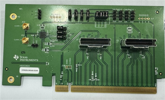

I apply for a piece of CEM2SLIMSAS-EVM
During the test, Jumper was set up according to the Quick-Star Guide.
But of the two SlimSas Connects, only J1 can operate normally.
J2 never recognizes the backend device
The current settings are as follows:
1. J10/J11/J14: Set Jumper to 2-3 (Low)
2. J4/J5/J6/J7: Set Jumper to 2-3 (Also tried 1-2)
3. J9: Set Jumper to 1-2/3-4/5-6/7-8
Do I need to set up J2 to recognize the device?
