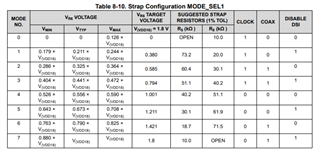

But when we turn on the BIST of UB924, the PASS pin is set low,So we want to know :1.what anomaly detection the BIST contains?2.How do I link and lock between UB941 and UB924?

    What MODE_SEL1 strap mode do you have the 941 configured when you are having LOCK with the 948?
    What MODE_SEL1 strap mode do you have the 941 configured when you are trying to achieve the 924?
    • 924 does not support coax mode in case you have the 941 configured to COAX. You will need to change the strap mode to Twisted pair.

    thanks for your reply,this problem has been solved.  The reason is a hardware problem,The mode_sel configuration of UB924 is incorrect, Set Repeat、BKWD、I2S_B  and LCBL to Low,then ub924 is locked
