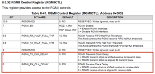

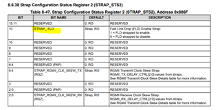

It seems that the default value of RGMIICTL[1:0] differs depending on the sample.
Is there anything that you think might be the cause?
<Details>
- According to the datasheet, RGMIICTL[1:0]=00b(default).
- In spite of the hardware and the software of the customer board are the same, there are the sample of RGMIICTL[1:0]=00b and RGMIICTL[1:0]=11b at default.
- The customer has not written to this register.
