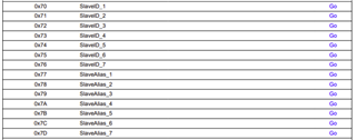

    If you need to program multiple aliases, you will need to use registers 0x07 and 0x08 for the first ID/Alias, then for the second, you should use the additional registers found in addresses 0x70-0x7D:

    This register can only be programmed for one remote device. The port select determines which port the remote device is accessed through. For the second remote device, please use the additional registers I mentioned previously.
