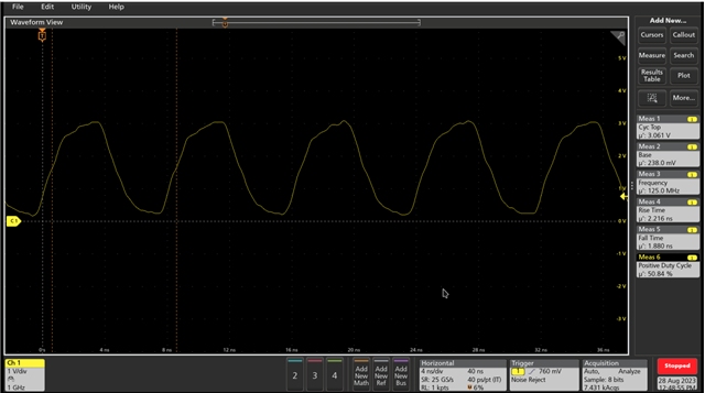

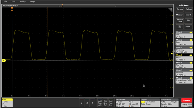

We did used 33R series resistor before and having more rise time. We did replaced it to 0R and TXC lines from soc is resolved from SI issue but no benefit on RXC line. Do we able to increase drive level in DP83867 part on RXC and RX pins (Pin32 to 36 & Pin38)?

  • Hi Hillman Lin,
    Default impedance is fix to 50Ohm on 0x0170 bit [4:0]. We will still try to adjust it.
    Mode is RGMII. RGMII mode kept default to aligned mode.
    TXC, RXC waveform is as attached.
    RXC with 0ohm Series register:
    TXC with 0ohm Series register::
  • Hi Kalpesh,
    Thank you sharing the waveform. We will wait for your result on 0x0170 register.
    May I ask did you see any functional issue due to the RX signal? Or you are concern about the signal quality on RX lines
    Could I confirm where did you probe the signal? Near the PHY side or MAC side?
