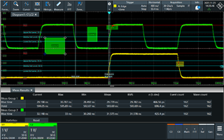

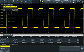

I have a question about some thresholds for TIC12400Q  chip.

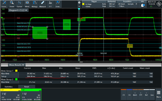

I saw that in the datasheet, we have max value 30 ns rise/fall times (for SPI signals):
And I am wondering with what value of the input levels this is applicable? For example, is it 20-80% or 30-70% thresholds?
I am asking because when I measure the signals for our PCB with 20-80%, we are out of specification.
