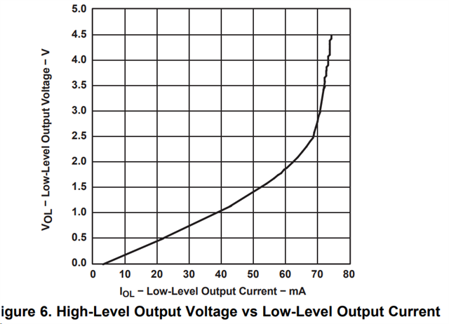

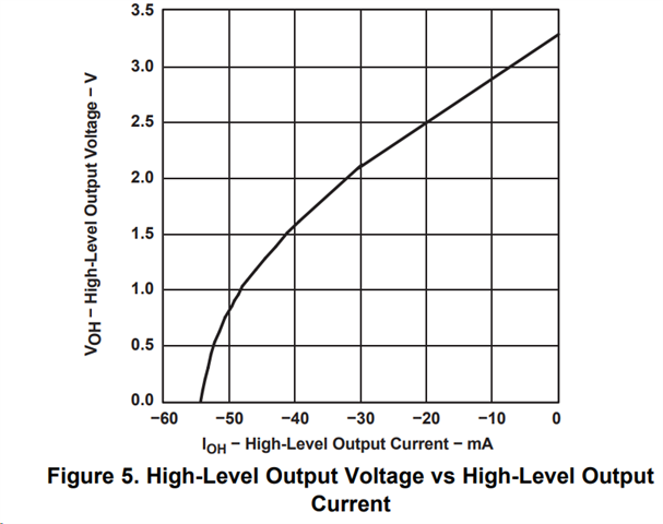

what is the maximum dc drive current of the single ended LVTTL output? I am using an 100Ohm/100Ohm thevenin termination, so I need to know if it is possible to drive it.
Thank you

However - we do test VOH and VOL values at sourcing/sinking 8mA maximum and if possible I'd try to keep current at +/-8mA at these pins for a recommended usage case. At 8mA the VOH is 2.4V and VOL is 0.4V (min and max respectively)
We also do give the output voltage versus output current of a typical receiver:
To keep LVTTL levels a typical device can maybe source/sink 30mA at room temperature conditions - but this won't account for temperature variations and this is a graph of 1 unit that was tested - so it isn't something that can be read as a guarantee - but a general idea of how the device will function.
So ideally keep it to +/-8mA - but if you push it you could see communication failures as shown in our VI curves of the LVTTL outputs.
