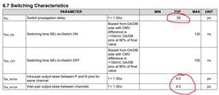

I am using TMUXHS4412 for a MIPI design, I found in the S parameter there are 8ps difference between P/N ports.
And in the datasheet the typical propagation delay is 4ps. So is 8ps the worst case? Is it always p port longer than N port?
