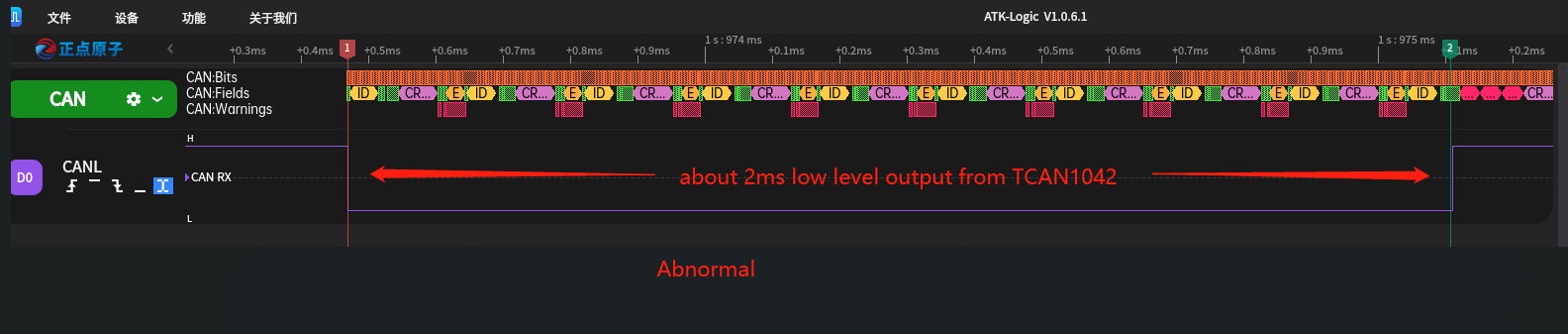

Dear TI expert,
Our product uses TCAN1042-Q1 as the CAN transceiver, we found a problem during the test, after the 1042 is awakened, it will continue to output a low level of 2ms, which causes the receiver device to continue to report errors, we try to replace the same type of CAN transceiver from other manufacturers, there is no such problem, what is the cause of this problem? And how can this be solved? Many thanks!

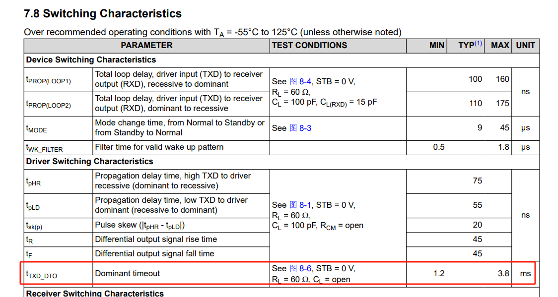

    The device should at most be taking 45us to transition to Normal mode from Standby, typically 9us. Can you share the STB pin state whenever this occurs?

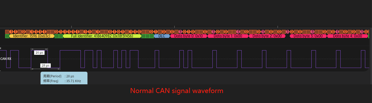

  • Hi Eric,
    Yes, maybe I'm not right, in fact, after powering on TCAN1042 it will start sending data to the next node, but there will always be a dominant level of 2ms, and then it can communicate normally. In terms of the length of time, this seems to be causing an explicit timeout, am I right? If so, why is this the problem? We don't have this problem when we use TJA1042.

  • Rogers,
    Apologies for the delay; I'll cover here while Eric is out.
    You're correct to identify the dominant time-out period as the likely culprit for why this dominant signal lasts so long. Do you know what the start-up time is for your MCU or controller? The dominant time-out is a feature designed to prevent a node from locking up communication if the TXD pin is locked low, as may be the case here.
    The TCAN1042-Q1 uses TXD as an input to determine what is transmitted on CANH/CANL. If you have a second channel, it would be much more helpful to see TXD on this same waveform. It could help us confirm whether TXD is being held low indefinitely.
    When floating, the TXD pin has a weak pull-up characteristic to help bias the TXD pin away from a dominant state. It does not otherwise have the capability to pull TXD low, so this would likely be a function of the controller or some other pull-down that's present on CAN_TX_ISO. Is this net possibly connected to a digital isolator that might be biasing the net to LOW for startup? If stronger than a few microamps, then it could be the culprit.
