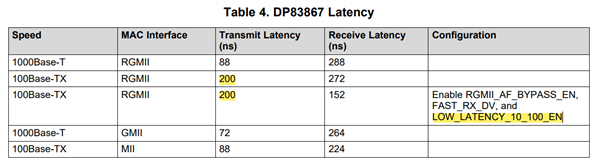

Hi Experts,
There is an application note about latency.
Importance of Latency in Factory Automation (Rev. A)
On table 4, there is a table showing the latency. For 100Base-TX mode at RGMII mode, the transmit latency is 200ns even though configuration is different.
Why is the transmit latency the same?
Also, when configuring below all bit to set 1 (enabled), are there any side effect?
RGMII_AF_BYPASS_EN Configuration
FAST_RX_DV Configuration
LOW_LATENCY_10_100_EN Configuration
