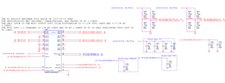

  • Heello, Zach
    The schematic is as follows:
    I2C is not used, and the settings are as follows.

    What is the data rate are you running? Is this a CSI or DSI application? What is the length of the output trace?
    Can you provide the insertion loss from the CPU to the input of the device?
    The configuration pin settings are all set to VIL. How was this decided?

  • Kim,
    Please try reconfiguring the configuration pins to see if this fixes the problem. You might try leaving each configuration pin floating and pulling ERC high.
    Also, could you take screenshots of the oscope of the input channel and the output channel of lane 0?
    Could you try using DA1P and DA1N pins instead of the lane 0 pins? If you want to continue using lane 0, then you need to make sure that you have a LP RX on the output of the DB0P and DB0N and a LP TX on the input of the DA0P/N pins.
