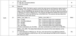

  • It seems that there is some issue with the register settings for the DSI clock division. Have you used the DSI register calculator tool?
    Its linked in the following e2e link: https://e2e.ti.com/support/interface-group/interface/f/interface-forum/945404/faq-sn65dsi86-how-do-i-programming-the-sn65dsi86-registers?tisearch=e2e-sitesearch&keymatch=sn65dsi86
    There should some form of error flagged. Could you check registers 0xF0 - 0xF8 when the display is blank and not working.
    Also try to get an internal color bar to display while using the DSI clock. This will help further isolate this issue.

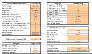

  • HI ,
    I used the register calculator in the first place to get the display to work with the refclk.
    is there a parameter in this calculator that should be changed when using the DSI clock?

  • The register to make sure you're using the DSI clock is register 0x0A
    Additionally we have a sample Linux driver, but we do not support any software, and anything provided is as is.
    Here is the link to the driver: https://git.kernel.org/pub/scm/linux/kernel/git/torvalds/linux.git/tree/drivers/video/omap2/dss/dsi.c?id=c16fa4f2ad19908a47c63d8fa436a1178438c7e7
    Please have a look at table 8.31 in the datasheet to debug your errors.
    It seems that the aux training completes successfully, but no data is sent.

    the output ASSR script from the register calculator (translated to bash):
    root:~# cat ./i2cset_ASSR_auo.sh
    #REFCLK Frequency #
    i2cset -y 1 0x2c 0x0A 0x0
    #DSI Mode #
    i2cset -y 1 0x2c 0x10 0x26
    #DSIA Clock #
    i2cset -y 1 0x2c 0x12 0x3F
    #DSIB Clock #
    i2cset -y 1 0x2c 0x13 0x3F
    #DP Datarate #
    i2cset -y 1 0x2c 0x94 0x20
    #Enable PLL #
    i2cset -y 1 0x2c 0x0D 0x1
    msleep 10
    #Enable ASSR in Panel #
    i2cset -y 1 0x2c 0x64 0x1
    i2cset -y 1 0x2c 0x74 0x0
    i2cset -y 1 0x2c 0x75 0x1
    i2cset -y 1 0x2c 0x76 0x0a
    i2cset -y 1 0x2c 0x77 0x1
    i2cset -y 1 0x2c 0x78 0x81
    msleep 10
    #Enable enhanced frame and ASSR in DSI86 #
    i2cset -y 1 0x2c 0x5A 0x5
    #Number of DP lanes #
    i2cset -y 1 0x2c 0x93 0x20
    #Start Semi-Auto Link Training #
    i2cset -y 1 0x2c 0x96 0x0A
    msleep 10
    #CHA Active Line Length #
    i2cset -y 1 0x2c 0x20 0x80
    i2cset -y 1 0x2c 0x21 0x07
    #CHB Active Line Length #
    i2cset -y 1 0x2c 0x22 0x0
    i2cset -y 1 0x2c 0x23 0x0
    #Vertical Active Size #
    i2cset -y 1 0x2c 0x24 0x38
    i2cset -y 1 0x2c 0x25 0x04
    #Horizontal Pulse Width #
    i2cset -y 1 0x2c 0x2C 0x10
    i2cset -y 1 0x2c 0x2d 0x00
    #Vertical Pulse Width #
    i2cset -y 1 0x2c 0x30 0x14
    i2cset -y 1 0x2c 0x31 0x00
    #HBP #
    i2cset -y 1 0x2c 0x34 0x98
    #VBP #
    i2cset -y 1 0x2c 0x36 0x0D
    #===== HFP #
    i2cset -y 1 0x2c 0x38 0x10
    #===== VFP #
    i2cset -y 1 0x2c 0x3A 0x03
    #===== DP-18BPP Disable #
    i2cset -y 1 0x2c 0x5B 0x0
    #===== Color Bar Enable #
    i2cset -y 1 0x2c 0x3C 0x12
    i2cset -y 1 0x2c 0x5A 0x0D
    #====== backlight enable #
    i2cset -y 1 0x2c 0x5E 0x0A
    i2cset -y 1 0x2c 0x5F 0x44
    can you verify the output please?
  • Hey Shlomi,
    As long as the registers are generated by the excel sheet they should be correct. This script confirmed works on the DSi86 EVM.

    is the script you pasted generated from the edid i provided? i don't get any 'read' commands on my generated script.
  • The color bar will be a 800x600 image that should fit within most displays. Works for multiple monitors on our end. When your setup is working are there any errors seen on the DSI86 EVM. The read is simply a double check the the I2c line is operating correctly, part of a script check function.
    Could you send the spec of your system rather than the EDID and i2c dump? My assumption is that the issue is due to the DSI clock being at a fringe frequency which is causing issue with the PLL

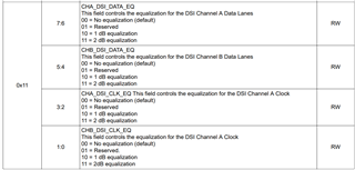

    0x0A
    0x11
    0x12 & 0x13
    if these registers are set up correctly there should be no issue in the bridge when transitioning from a working refclk to a DSI clock.
