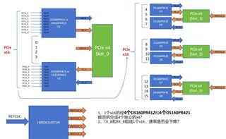

Please kindly check if we can use the DS160PR412 and DS160PR421 for the below block diagram, thanks.

The diagram looks OK to me. However it seems like devices do not use Port B and therefore the mux/demux switching feature is not used. Is there a reason for this? If there is no intention to use the mux/demux features in the future, then a normal redriver like the DS160PR410 would typically be simpler.
