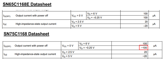

SN65C1168E: Driver output current (Io_off) when the power is OFF
Part Number: SN65C1168E
Other Parts Discussed in Thread: SN75C1168,
Hi experts,
My customer is considering sn65c1168e as a replacement for discontinued product: sn75c1168.The sign of the driver output current when the power is OFF appears different. Is there a difference in driver output current between these two devices?
Looking at the circuit diagram of the driver output stage, it seems that there is no change in the direction of the output current, but the signs are different, so is this correct?
Thank you for your help.
