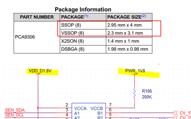

Dear Team,
Can the left and right Vref be connected to 1.8V as a switch?
I'm worried that there will be a problem with the internal MOS bias voltage. Thanks a lot.

  • When using the PCA9306 as a switch, you connect the EN pin directly to the (lower) supply voltage. In that case, VREF1/VREF2 are not used (and the 200 kΩ resistor is not necessary); you can let them float, connect them to the same voltage on both sides, or use them as a third data channel.
  • Hi Jimmy,
    I agree with Clemens' answer here. You may also refer to section 8.1.5 of the datasheet for more information.
    Jack

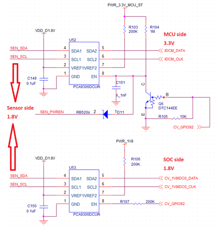

  • Hi Jack,
    I compared spec's 8.1.5
    It seems that the main difference is that switch mode EN can be directly pulled out to control
    In translation mode, both Vref2 and EN2 need to have 200K pull up.
    Our current design requirements are as follows
    Please help me confirm the line below.
    1. MCU 3.3V, SoC 1.8V, Sensor 1.8V
    2. U52 is translation mode, U53 is switch mode
    3. Only U52 or U53 turn on at the same time
    (Use CV_GPIO92 to control U53, and use BJT to reversely control U52)
    4. If SEN_PWREN is pulled low, U52 and U53 will turn off.
    Many Thanks,
    Jimmy
  • In translation mode, VREF2 and EN must be connected together. (You then do not need R104.)
    In switch mode, EN must not be higher than the lowest signal, i.e., in this case, CV_GPIO92 must be 1.8 V. R107 is not needed.
    Q6 has an internal pull-down, so R105 is not needed.

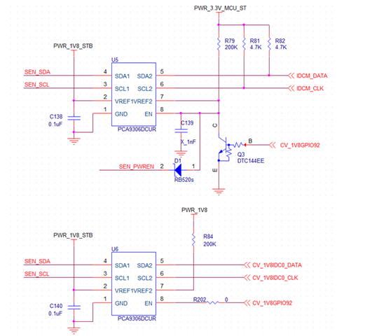

  • Hi Ladisch,
    Thanks for your great support.
    I have already modified circuit as your recommendation.
    CV_1V8GPIO92 is SoC GPIO, the IO level is 1.8V.
    The new SCH is as below.
    Many Thanks,
    Jimmy
  • Looks OK.
