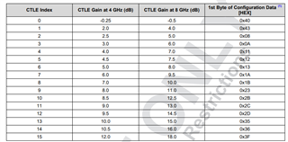

  • Hello Evan,
    I tried the same test for 1 GHz also.
    In Sigcon Tool using EQ index values, we can add the gain(we can boost the signal gain)for individual channels.
    In the datasheet they have provided gain values for each EQ index value.
    Until now, this was my understanding. Correct me if I am wrong.
    Sandhya
  • Hi Sandhya,
    The gain values in the datasheet tables you shared are the magnitude of the frequency response of the amplifier at certain frequency points (8 GHz is relevant for operation at Gen 4 speeds, 4 GHz is relevant for operation at Gen 3 speeds). They can be interpreted as a rough measure of how much compensation can be provided for the degradation of high-speed signals, but do not reflect the magnitude of the waveform as a whole.
