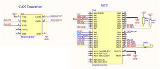

  • Thanks for the reply!
    I've inserted a part of the schematic below.
    The TCAN334 has no CAN bus activity, this has been measured with the oscilloscope.
    Once we replaced the TCAN334 with the SN65HVD230DRG it worked properly.The TCAN334 Pin 5 is not used. Additionaly we tested an STM-8 instead of the STM-32, then the TCAN334 does function.

  • Dennis,
    It's strange that one micro works vs. the other, this indicates some kind of logic level not being met, or something else entirely, I'm not sure. Leaving both pins 5 and 8 floating on TCAN334 should be okay since they are both internally pulled down, and thus the device defaults to Normal mode. What is the voltage of the CAN bus with TCAN334 when working with the STM-32? And can you get the TXD waveform as well?
