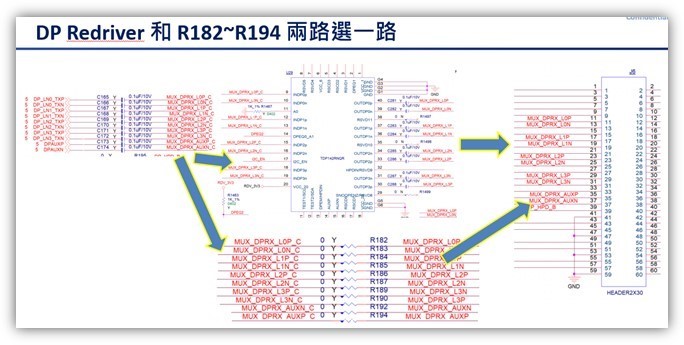

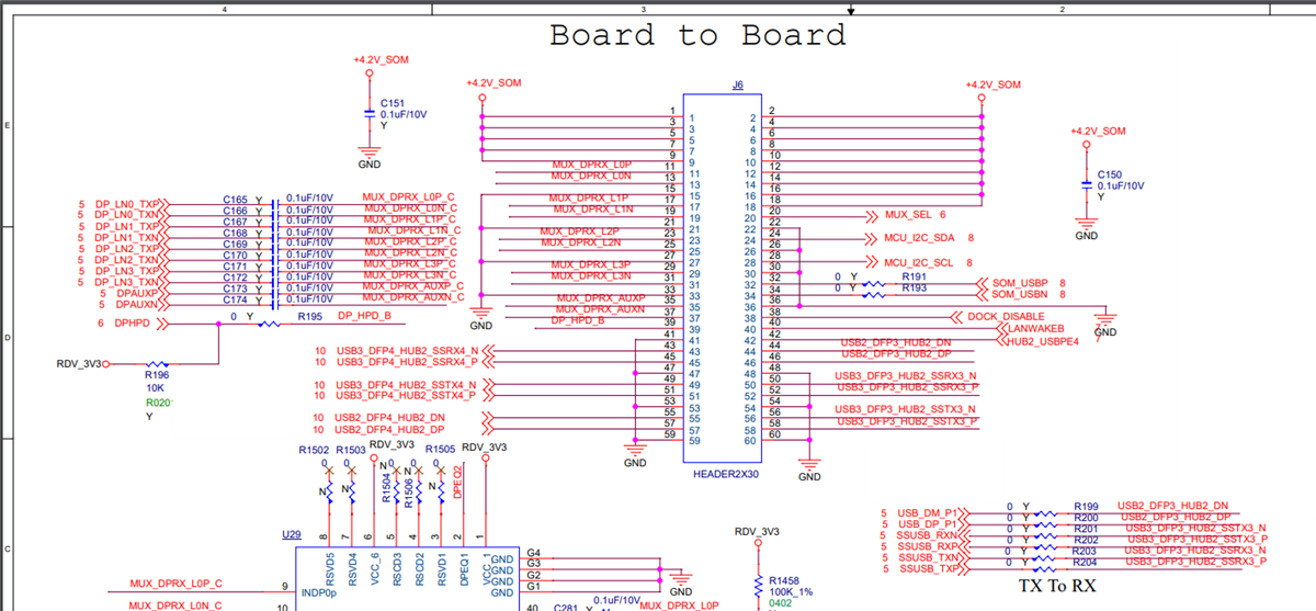

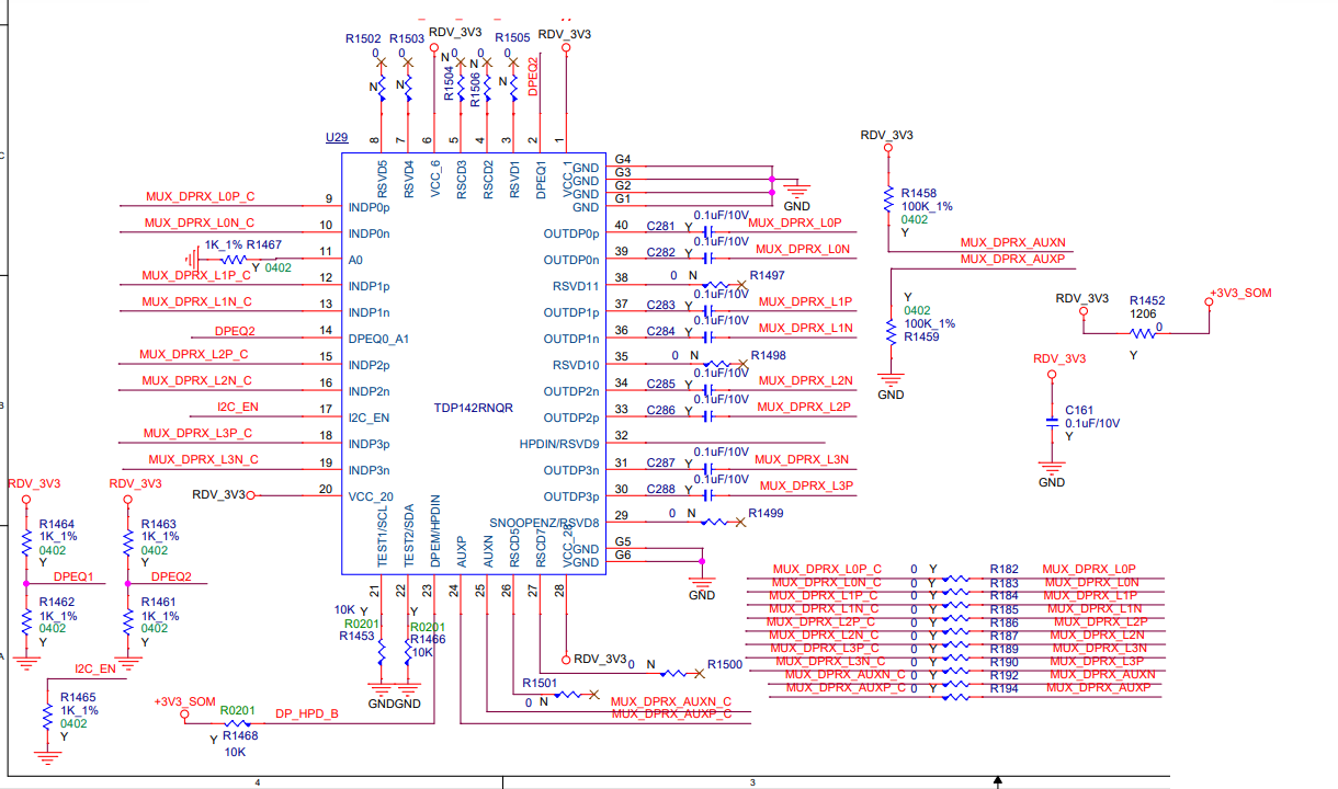

please help to review if below schematic need any modify. We have reserved TDP142 if needed. DP re-driver and R182~R194 may choose one way for DP signal.
thank you!

Hello, Jeff,
Why do you want to bypass the redriver? Is this a prototype board?
I can review the schematic and get back to you shortly.
Zach
Jeff,
Please see attached. Who is the customer here and what is the application? Is this a source side device?
TDP142_schematic_review_for_jeff.pdf
