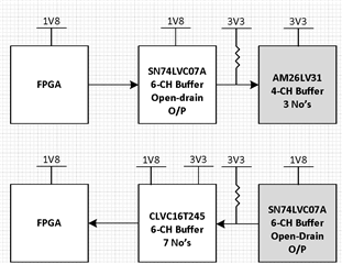

Kindly find the attached diagram for buffer connectivity verification
1st Set:
FPGA driver: LVCMOS 1V8
SN74LVC07A: Open-drain Output
AM26LV31: RS422 O/P
2nd Set:
CLVC16T245: Level Translator
FPGA : LVCMOS 1V8
Could you verify this one and tell me know is there any disadvantage of using open-collector output to RS422 input instead of Push-Pull buffer
