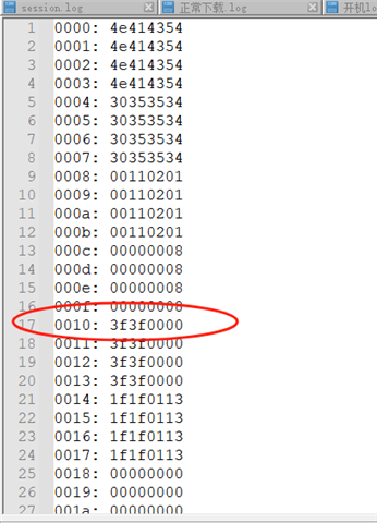

  • If the chip can be sent, but cannot be received, receiving will not even trigger an interrupt. What is the general reason? How can the problem be identified and resolved?
    This TCAN4X5X_ Error_ The register specification book for STATUS also does not specify
  • Hi Tony,
    I'm not sure what you are trying to show me with the SPI Error Status Mask Field register value.  The Status register 0x000C doesn't show any errors, just that there is internal device activity which is normal.
    I can help review and debug the register configuration if you can provide me a list of all the register values.  Also, can you tell me what specific message they are trying to send and receive?
    Can you also read the following registers after you have tried to transmit and receive a message so that I can check for CAN specific errors?
    0x1050 (MCAN Interrupt Register)
    0x1040 (MCAN Error Counter Register)
    0x1044 (MCAN Protocol Status Register
    0x10A4 (MCAN RX FIFO 0 Status
    Thanks and Regards,
    Jonathan
