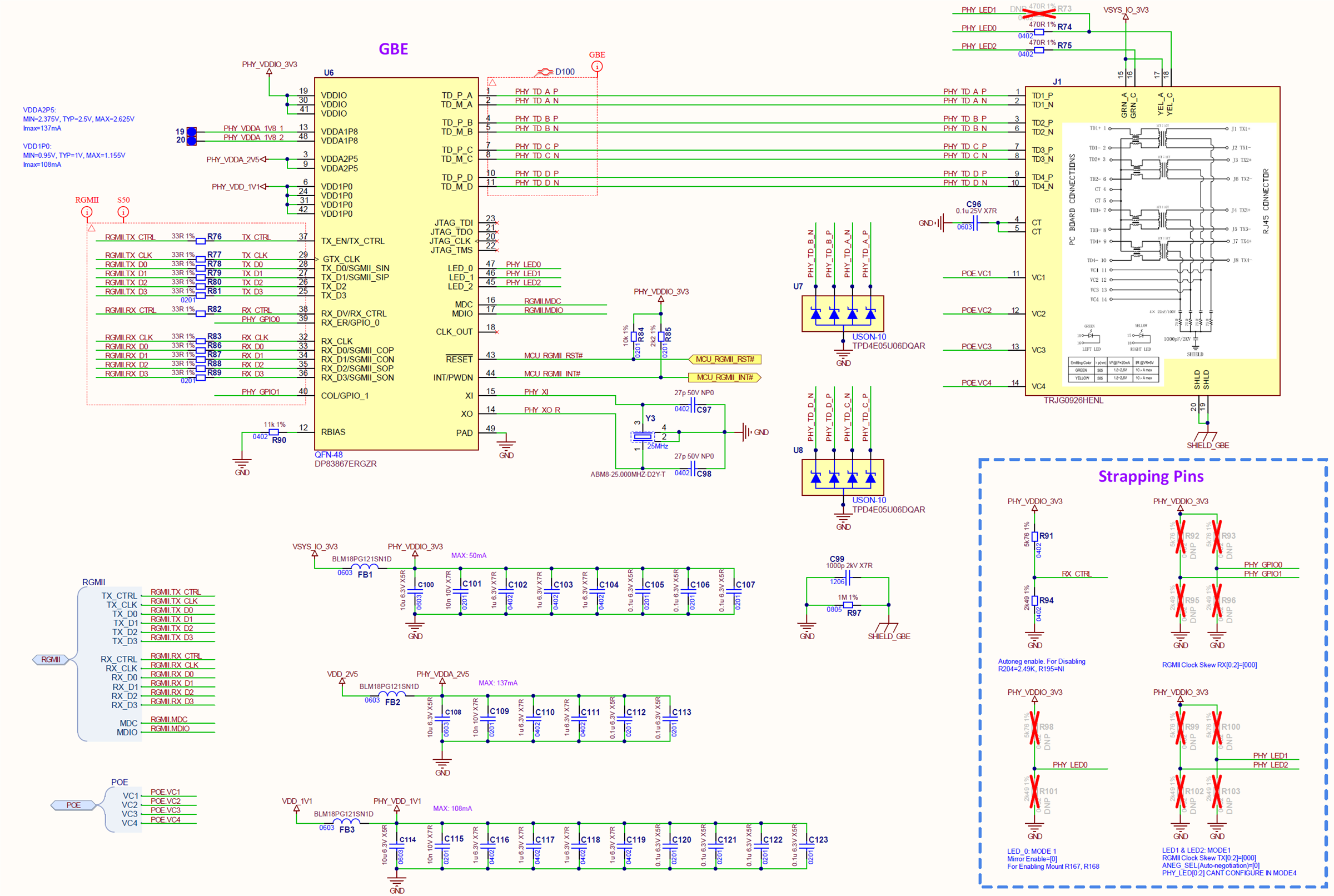

Our design includes a gigabit PoE ethernet interface based around the DP83867 PHY, and we're currently unable to establish a network link of any kind. We have confirmed that we are able to communicate with the PHY and read its configuration registers from our MPU. Below is our schematic.

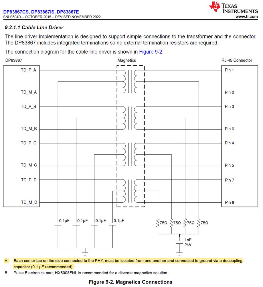

The PHY datasheet discusses requirements for the magnetics and mentions that the center taps on the PHY side must all be isolated and individually bypassed with 0.1 uF capacitors. The RJ45 jack we have chosen does not bring these center taps out individually and instead busses them all together, so we are thinking this may be the culprit here. But I was hoping for some clarification on this because it's hard to see how bussing these center taps would affect the differential signals going in and out of the PHY.
Here's the excerpt from the PHY datasheet:

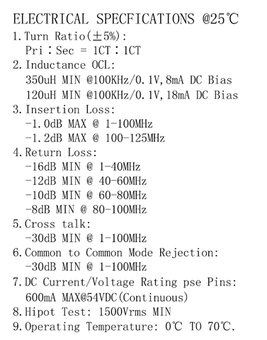

    I also took a look at the transformer that you are using, the TRJG0926HENL (link is where I found the specs for this part) and it meets the requirements listed in Table 9-1 Magnetic Isolation Requirements of the data sheet. Please follow the troubleshooting guide and let me know if it helps find the issue or if there is something missing from the guide that we could add.

  • Alvaro, thank you for your reply. I went through much of the troubleshooting guide and I didn't find anything that looked particularly concerning. I did make the 100 ohm terminated RJ45 cable and confirmed that the auto-negotiation pulses are appearing on the bidirectional pins of the jack.
    I replaced our RJ45 connector with a non-PoE connector (TE 6-2301994-2). that has individual capacitors on the center taps, and it worked.
    I also tried using our current connector (Trxcom TRJG0926HENL) while removing all PoE related components from the board, and it did not work.
    I'm still not clear why our current jack does not work. Do you have any more thoughts on this?

    Thank you for providing the information so clearly. The Center taps bussed together never works, even without the POE circuitry.

    The DP83867 is a voltage line driver (for the MDI side communication), where the line transmitting data are sensitive to DC voltage. On your current connector, try probing CT 4 & 5 and see what voltage you get and compare that to P1 on the connector that works.
