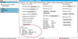

My customer uses a 949EVM and the system shows below. Their 948 board is designed by themselves. They can see the content when using 949 pattern. However, they cannot see anything when using the PC as a HDMI source. They can see the HDMI active in ALP. It shows 720p detected. I believe it is because our default EDID only supports 720p.
System:
Timing:
ALP status:
You can see that they have a LVDS to DSI device in the system and the display does not have a EDID, so I generate a 1080P EDID and write a script to write the EDID register. It works and the ALP can detect a 1080p source. However, the screen still shows nothing.

    Maybe it is because PC sends a timing that the TCON cannot suffer. How can we know the timing from PC? Or if you have any experience on PC - 949EVM system?
    Peter
  • Hi Peter,
    What are the MODE_SELs set to on the 949? For HDMI compliant devices, the EDID from the source will be read whenever the HPD signal is asserted. If the new EDID is written after the PC has already read the default 949 EDID, then the source will not retransmit the new timing.
    The MODE_SEL option that allows the user to load in custom EDID before HDMI initialization is EXT_CTL. If EXT_CTL is set, then the HDMI initialization will not continue until the user turns control over to the internal state machine.
    The PC is not able to see the TCON. The PC only interacts with the 949 via the HDMI protocol.
    Jack

    Today I went to customer's lab and debugged with them. I found their MAPSEL was wrong and EDID not totally right. Then I revised their setting. The problem was fixed. Thanks for your support.
