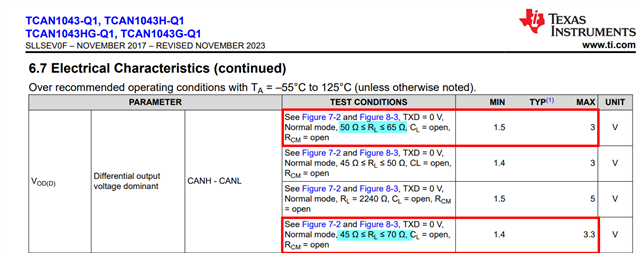

One of our customers is testing the conformity of the TCAN1043DMTRQ1.
The RL used is 62 Ω and the dominant level is 3.12V. The RL=62Ω in the figure above corresponds to two voltage ranges, how should we tell if this test passes? And I would like to know why there are two parameter criteria?

    The two datasheet parameters for differential output voltage are based to the normal bus load and extended bus load definitions in the ISO 11898-2 CAN standard document which lists these two characteristics as separate table items (table 5).
    The output voltage higher than 3.0V in the normal bus load case is not expected, but is not concerning as a higher differential here is beneficial to the signal integrity of the system. The discrepancy may be due to a difference in measurement methods, load resistor variance, or a slightly higher voltage supply on Vcc.
