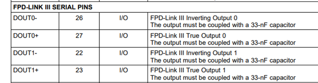

For UB948 AC-coupling cap selection, how to understand below screenshot? Is it a typo, both items are for RIN[1:0]+?
For UB947, what should we do for Dout1- and Dout1+ if we only use 1 link FPD-LINK output and work as coax mode?

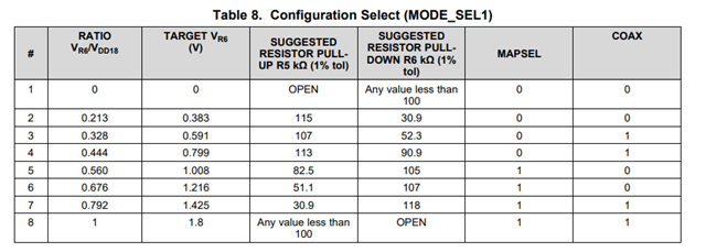

For UB947, what is the difference between number 1 and 2? Same question between 3 and 4.
    Yes, this is a typo. The second line should be for RIN[1:0]-
    For DOUT+ you can use any value between 33- 100nF, and for DOUT- you should use half the value of the DOUT+.
    There is no difference, #1 and #2 are the same.
    For UB947, if we only use 1 link FPD-LINK output, what should I do for DOUT1+/-? NC them or what?
    For UB947>>UB948 coax system, I met 948 unlock issue (948 never lock).
    UB947: Single OLDI port input, 1 link FPD-LINK output
    UB948: 1 link FPD-LINK input, single OLDI port output
    I checked 947 and 948 schematic as datasheet reference schematic, and also checked the MODE_SEL of UB947/UB948, the PCB layout of UB947/UB948.
    947 mode_sel:
    948 mode_sel:
    What things can we check? I think it's really strange.

  • Hello Jiawei,
    If the other port is unused, you can leave as no connect.
    Please check the connector pins polarity if correct or not.
    Also, You may check if the 947 is receiving data at it's input or not. Check register 0x5A
