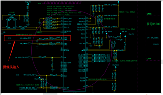

附件3:摄像头连接原理图

       Is there anything wrong with the configuration of my ub954-ub933 mentioned above? The  system schematic is attached in the problem. Now I suspect that the camera cannot display normally because of the configuration problem. Where can I check.

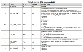

    I see in the schematic, only the first two CSI lanes are being used but four lane forwarding is selected. Would you be able to first update UB954 0x33 from 0x03 to 0x23?
    If the problem persists, I recommend testing with pattern generator from the deserializer and serializer. Has this testing been done?
